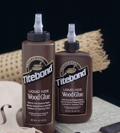

I came across these 2 Titebond Glues and was wondering if anyone has ever used them or any comments regarding them.
The Hide glue in Liquid ready to use form sounds real good!
Here's what they say about it:
Titebond Liquid Hide Glue is the first hide glue to be offered in a liquid, ready-to-use form. It requires no mixing, heating or stirring. Professional woodworkers use Titebond Liquid Hide for its long assembly time, exceptional strength and unique crackling effect on wood.
"Titebond Liquid Hide provides superior creep-resistance, offers excellent sandability and is unaffected by finishes. Its sensitivity to moisture allows for easy disassembly of parts, a critical benefit in antique restoration or the repair of musical instruments. "
And Titebond III:
"Stronger, safer, easier to clean up and less expensive than polyurethane glues.
Allows eight minutes of open time and has an application temperature as low as 47? F.
One hour clamp time!
Cleans up with water.
Does not foam"

I did some tests with the Liquid hide glue and it failed miserably. Glued
up cocobolo blocks and the next day I could break them apart fairly easy
where Titebond original would not budge.
Never tried the titebond III. But the titebond original is good stuff. It's all
we used (except for the superglue for those certain things) at pantheon,
and those guitars are awesome.
I have grown to prefer hot hide glue 192 gram from Milligan and higgins
over any glue thus far. I still use titebond on some large surface glue
jobs where I'm not fast enough for the hide glue, but I'm working on
getting faster so that I can use the hide glue exclusively.

Liquid hide glue = not good for guitarmaking , useful (but not the best) for general woodworking.

liquid hide might be ok for tacking on the nut, but i can think of little else it might be good for given its poor bond strength. someone once suggested the fb tongue might be a candidate for its use, but the way some players flex their guitars to bend all strings at once i would worry that it would release.

Well here is something I have not read before on the various forums and posts about glue the last few years, one of the new woodworking mags suggests using liquid hide and sawdust for filling. It sands easily and would be about the same color as the surrounding wood. Also if you wanted to stain it stains well which other glues dont do.

Titebond III was conceived (according to the manufacturer) as a less expensive and easier-to-use substitute for polyurethane. It's waterproof, heat resistant, contains no hazardous solvents, and it cleans up with water. It also bonds effectively at lower temperatures than does original Tightbond, and it has a bit longer open time, IIRC. Its waterproof/heat-resistant qualities make it questionable for general lutherie. As for the liquid hide glue, all the expert luthiers seem to agree--the additives used to make it liquid at room temperature (usually urea) weaken its bonding strength.
John...French Polishing expert Eugene Clarke says that whenever he's run across a failure in FP finishes (softening or chipping/peeling) on pre-20th century guitars, they had been filled with hide glue! It just doesn't seem to me that you could get hot hide glue spread evenly into the pores of a meaningful patch of wood before it gets too cool. Okay for furniture, not for guitars.CarltonM38769.7085300926
